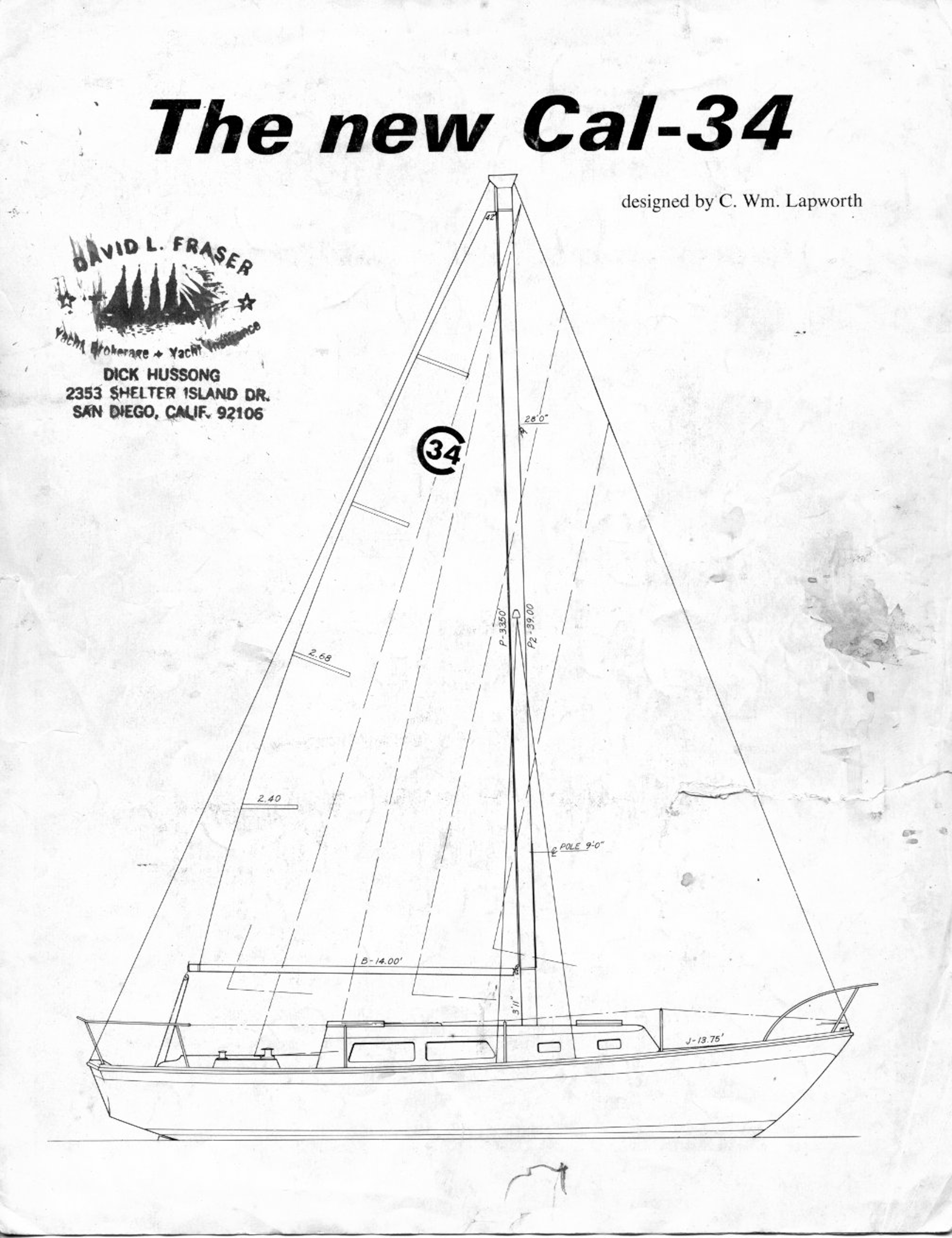

I'd like to know if anyone can tell me what was "standard issue" headsail size from the factory? I feel like the previous owner went too far outside the bounds of normality with the 160. I'd like to get something Mr. Lapworth would approve of. The picture on sailboatdata.com is too low res, but I found a higher res version online...

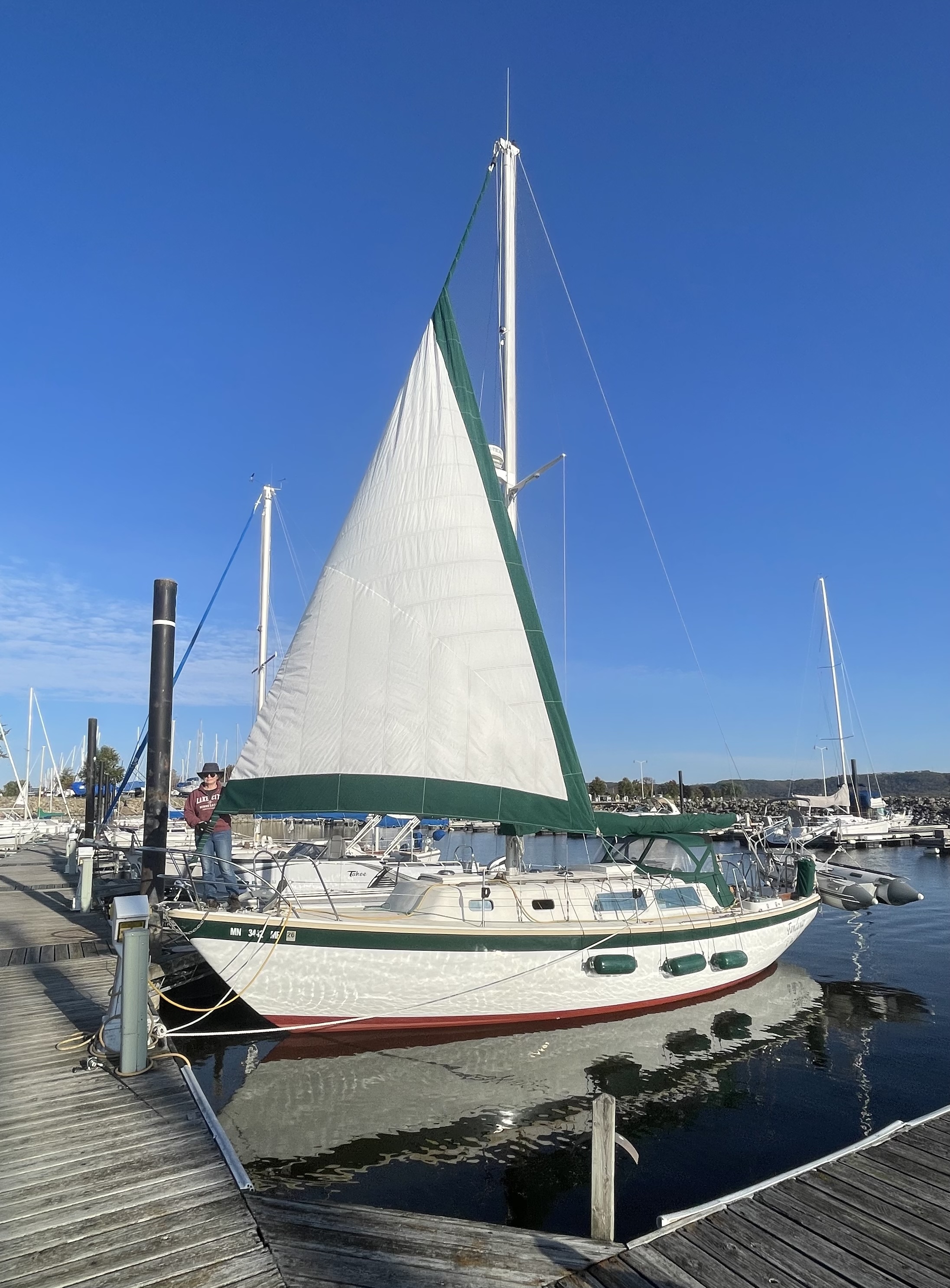

p.s. Here she is when we were taking measurements on Saturday at the Marina in Lake City, MN. Note the new davits, sure love those!
p.p.s. here is a high-res scan from the owners manual PDF found online, much better than the one at sailboatdata.com. I don't know how to read it.

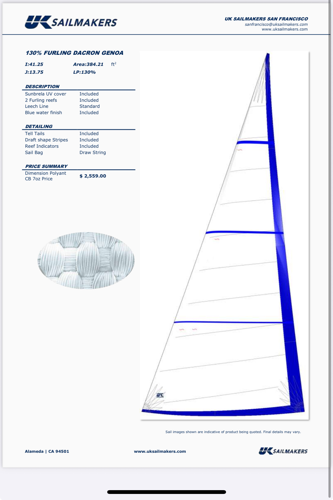

Hi, I have a 1978 34-III, so it has a higher aspect rig. I had a new sail made that is a 130 back in 2021. At the time, I was planning to bring the boat down to Southern California where the winds are lighter. I have decided to keep the boat in the San Francisco Bay, so the sail needs to be furled when the winds pick up. When the wind is around 8-10 knots or so, this sail is great points well, and sails in lighter winds also. If I was to do it again, I’d go smaller. I also like to be conservative with how much sail I have out in the SF Bay because of the gusty conditions. Very different conditions than you have, though. I usually have a downwind sail back to the marina, and I appreciate the big sail then. UK Sails did a great job.
I attached screenshots of the sail info.
I would recommend getting in touch with Eric Heim with Quantum Sails. He owns a Cal 34 and also just crewed on the winning Cal 40 in this year’s TransPac, so he could answer all of your questions and spec your sail.. he is very knowledgeable and a nice guy.
