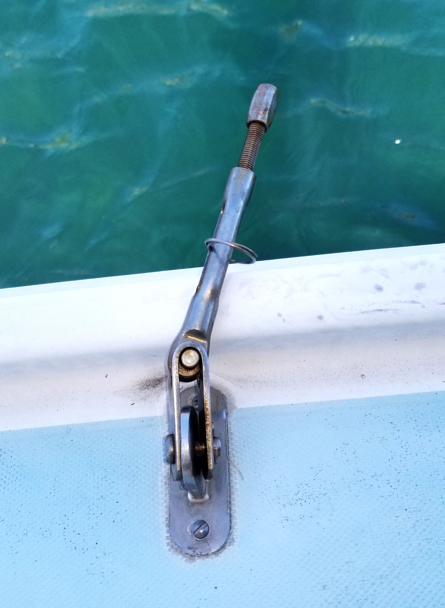

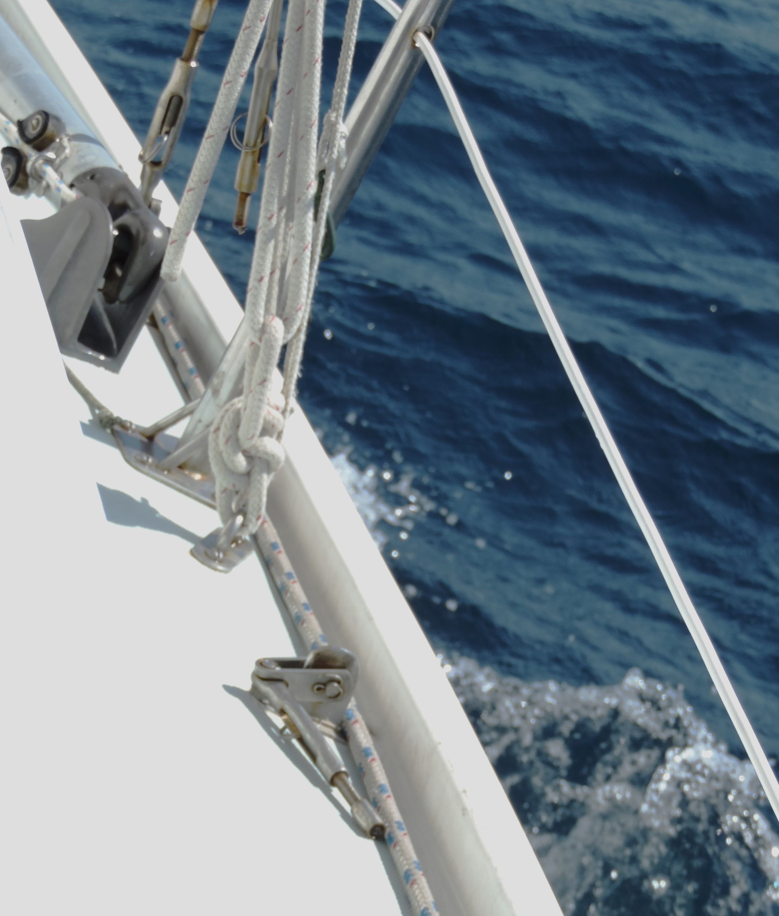

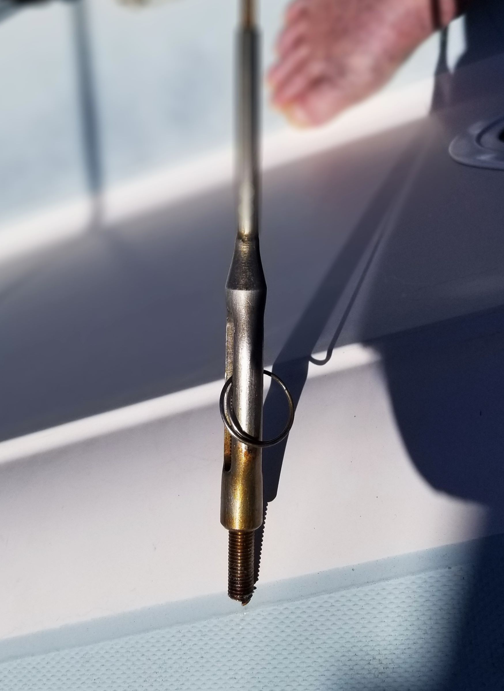

A loud bang and the aft starboard lower turnbuckle shot up the mast. I started heading into the wind to relieve the pressure on the rig. The mate was starting the engine. The boat was just reaching dead into the wind and I put the engine in gear.... nothing. The engine just tached up, the transmission had not gone into gear. I retried shifting through reverse and neutral.... nothing. The boat has now gone past the point of being into the wind, the big 165 is backing and the main is starting to catch wind. Running through my mind was a funny clunk I heard when putting the transmission into reverse when we started the sail. The mate took over the helm and continued to work at the engine and transmission controls. I cast off the main and jenny. I roller furled the headsail but the main was still pressuring the mast. I heard the satisfying noise of the little diesel picking up the strain, the mate had got it to go into gear. The mate guided our compromised old girl into the wind. The main came down and was furled. I went on the foredeck and grabbed the spinnaker halyard, led it under the spreader and to a deck eye near the aft chainplate. I put as much tension on it as I could and tied it off. I plopped back onto the cockpit cushions, we were back under control. We had a discussion about our options. Heading back to the mainland was off the table because I had promised the mate dinner out for our anniversary. We were still about a hour out of the Isthmus, so I could effect repairs to the shroud and continue sailing or we could just power (uggh!) the rest of the way. Without sails to steady us the confused seas were rocking us gunnel to gunnel.

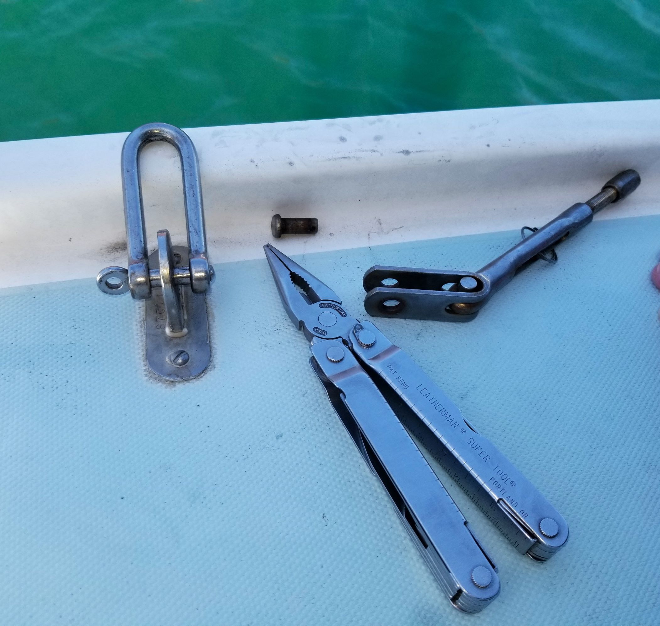

Time to dig in on the rigging task. I have a store of all the rigging supplies I might need. This should be a easy fix. A shackle on the chainplate. A second shackle connected to a heavy aluminum bar. A third shackle connecting the bar to a old turnbuckle. Finally a loop of the shroud made with cable clamps connected to the turnbuckle. I started in.
I took a break to move some of the halyards around. As I reached for the starboard forward lower I got a surprise. Five feet up from the turnbuckle the shroud had stranded. Long corkscrews of shiny cable were hanging out. I had completely replaced these forward lowers about 5 years ago. The only rigging newer are the capshroud chainplates. Time to reassess. I met with the mate. The turnbuckle failure was undetectable, hidden by the adjustment nut, there was no way to see the condition. We have six of the same age and type turnbuckles in our rig. The forces when the turnbuckle failed were so great as to strand new cable when it took the load. We decided that I am not gong to continue the repair. I'll use the spinnaker pole topping lift to take the place of the lower and steady the mast. We will have to power home when we go. We are faced with a full standing rigging replacement.
